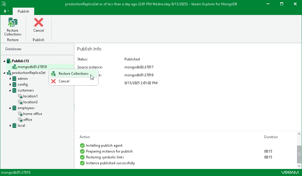

To restore databases from the published instance, do the following:
  1. In the navigation pane, under the Publish node, select a published instance.
  2. On the Publish tab in the ribbon menu, select Restore Collections. You can also right-click the published instance and select Restore Collections.

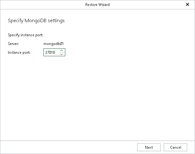

Restoring Published Databases
  1. At the Specify MongoDB Settings step of the Restore Wizard, specify the port of the instance to which you want to restore your collections.
Specify Target Instance
  1. Proceed with the Specify Replica Set Credentials step of the Restore Wizard. Complete the remaining steps of the wizard to restore your collections.
