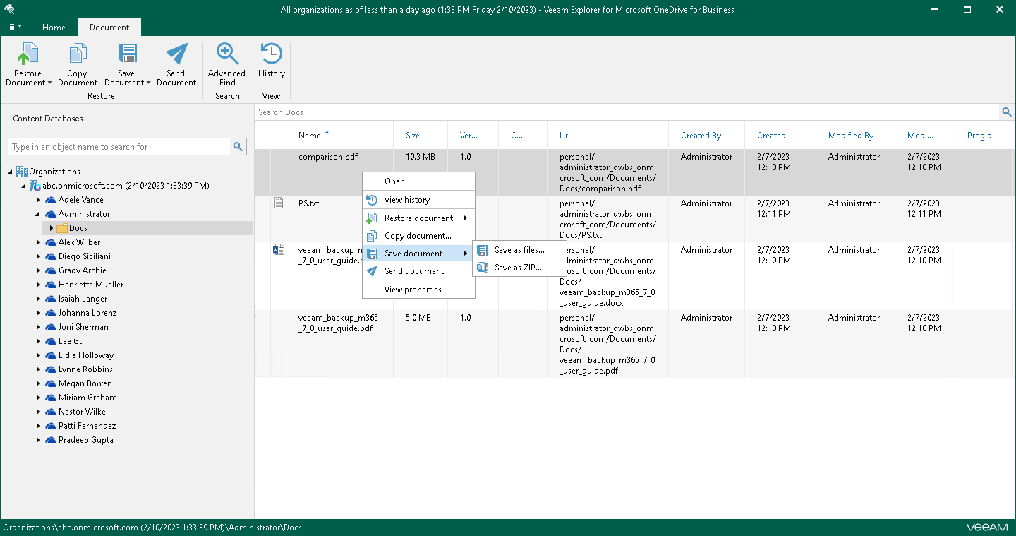

To save a document, do the following:
  1. In the preview pane, do one of the following:
  • Select a document that you want to save, and on the Document tab, click Save Document > Save as files or Save Document > Save as ZIP.
  • Right-click a document and select Save document > Save as files or Save document > Save as ZIP.
  1. In the displayed window, browse to the necessary folder and click Select Folder or Save.
Keep in mind that if you select the Save as ZIP option, Veeam Explorer for Microsoft OneDrive for Business will save a document to an archive with the archive.zip name.
