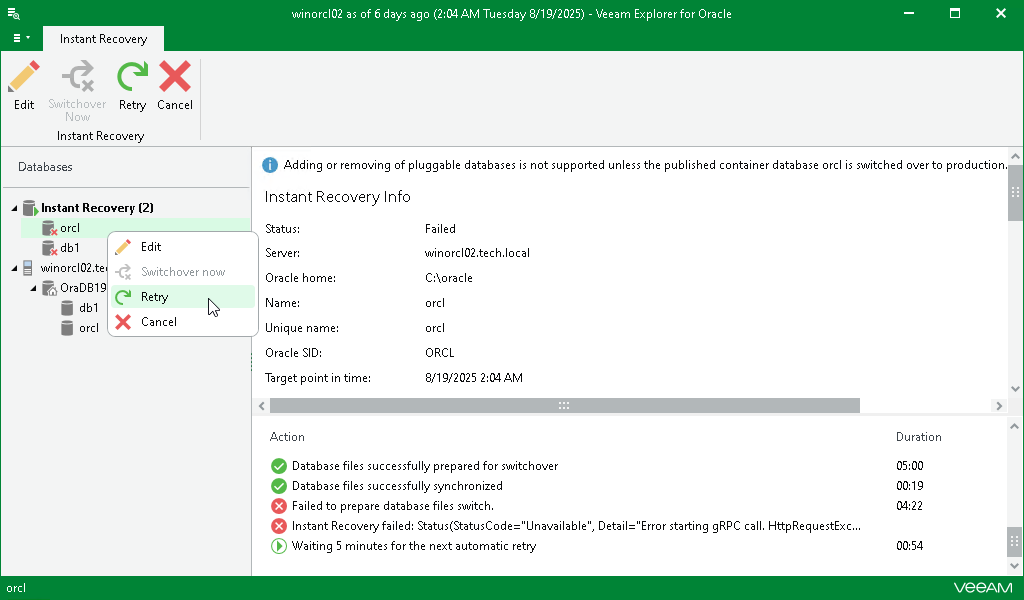

If anything disrupts the recovery process (the target or mount server crashes or the network is down), the recovery process stays in the waiting mode and performs 10 automatic retries every 5 minutes. If the retries fail, you can launch the retry manually after the server or network is up.
To start the retry process manually, do the following:
  1. In the navigation pane, under the Instant Recovery node, select the database.
  2. On the Instant Recovery tab, click Retry.
Alternatively, you can right-click the database and select Retry.
Starting the Retry Process Manually
