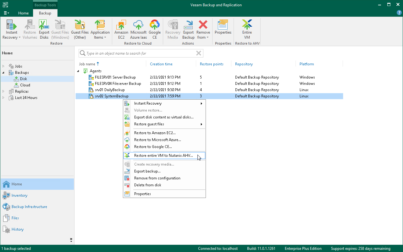

You can use the Veeam Backup & Replication console to restore a Veeam Agent computer as a Nutanix AHV VM in your virtualization environment. For restore to Nutanix AHV, you can use backups created on the Veeam backup repository. You cannot perform this operation with Veeam Agent backups created on the Veeam Cloud Connect repository.
Mind that to restore to Nutanix AHV, you must install Enter value on the Veeam Backup & Replication server. To learn more, see the Installation section in the Veeam Backup for Nutanix AHV User Guide.

The procedure of restore to Nutanix AHV for a Veeam Agent computer practically does not differ from the same procedure for a VM. To learn more about restore to Nutanix AHV, see the Restoring VMs Using Veeam Backup & Replication Console section in the Veeam Backup for Nutanix AHV User Guide.
Restore to Nutanix AHV VM
