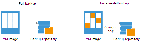

When Veeam Backup & Replication performs incremental backup, it needs to know what data blocks have changed since the previous job session. To get the list of changed data blocks, Veeam Backup & Replication uses the changed block tracking mechanism, or CBT. CBT increases the speed and efficiency of incremental backups.

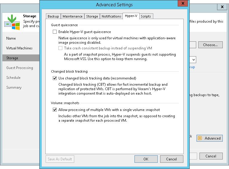

Veeam Backup & Replication enables CBT. You can disable it either at the host level or at the job level for troubleshooting purposes. Note that if you choose to run incremental jobs with CBT disabled, the backup window may increase dramatically, as Veeam Backup & Replication will read all VM data to detect what blocks have changed since the last job session.

The CBT mechanism is implemented as a file system filter driver — Veeam CBT driver. The driver is installed on every Microsoft Hyper-V host added to the backup infrastructure. The driver is activated when the host is first addressed by a job for which CBT is enabled.
The Veeam CBT driver keeps track of changed data blocks in virtual disks. Information about changed data blocks is registered in special CTP files. When a job runs, Veeam Backup & Replication uses CTP files to find out what data blocks have changed since the last run of the job, and copies only changed data blocks from the disk image.
