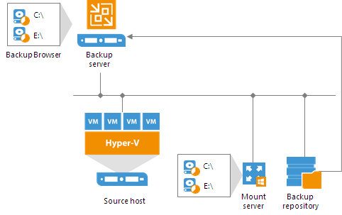

When you restore files from backups that reside on the backup repository, Veeam Backup & Replication uses the following mount points:
- Veeam Backup & Replication mounts disks of the VM from the backup file to the machine where the restore process is launched. This can be the backup server or machine on which the Veeam Backup & Replication console is installed. This mount point allows you to browse the VM file system.
- If you restore files to the original location, Veeam Backup & Replication creates an additional mount point on the mount server associated with the backup repository on which the backup file resides. The second mount lets you keep the VM traffic in one site and reduce load on the network.
If you restore files to a new location (perform the Copy to operation), Veeam Backup & Replication does not create the second mount point. It copies files to the destination from the backup server or Veeam Backup & Replication console machine.

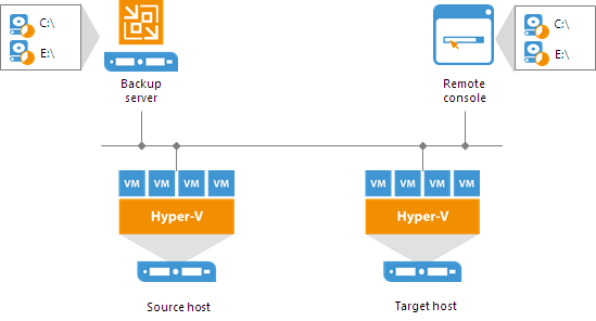

When you restore files from a VM replica, Veeam Backup & Replication uses the following mount points:
- Veeam Backup & Replication mounts disks of the VM replica to the machine where the restore process is launched. This can be the backup server or machine on which the Veeam Backup & Replication console is installed. This mount point allows you to browse the VM file system.
- If you start the restore process from the Veeam Backup & Replication console and restore files to the original location, Veeam Backup & Replication creates an additional mount point on the backup server.
If you start the restore process on the backup server or restore files to a new location (perform the Copy to operation), Veeam Backup & Replication does not create the second mount point. It copies files to the destination from the backup server or Veeam Backup & Replication console machine.

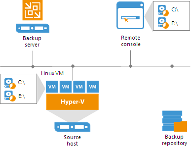

- To create a mount point on Microsoft Windows machines, Veeam Backup & Replication uses the iSCSI protocol. The remote machine or staging server acts as an iSCSI initiator. The machine on which the Veeam Explorer runs acts as an iSCSI target. The iSCSI mount point is non-persistent — it is created only for duration of the restore process.
- To create a mount point on Linux VMs (for Oracle running on Linux), Veeam Backup & Replication uses fuse.
