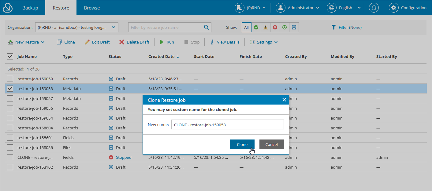

  1. Click Clone.
  2. In the Clone Restore Job window, specify a name for the new job, and click Clone.
After you clone the restore job, you can edit settings of the new draft.

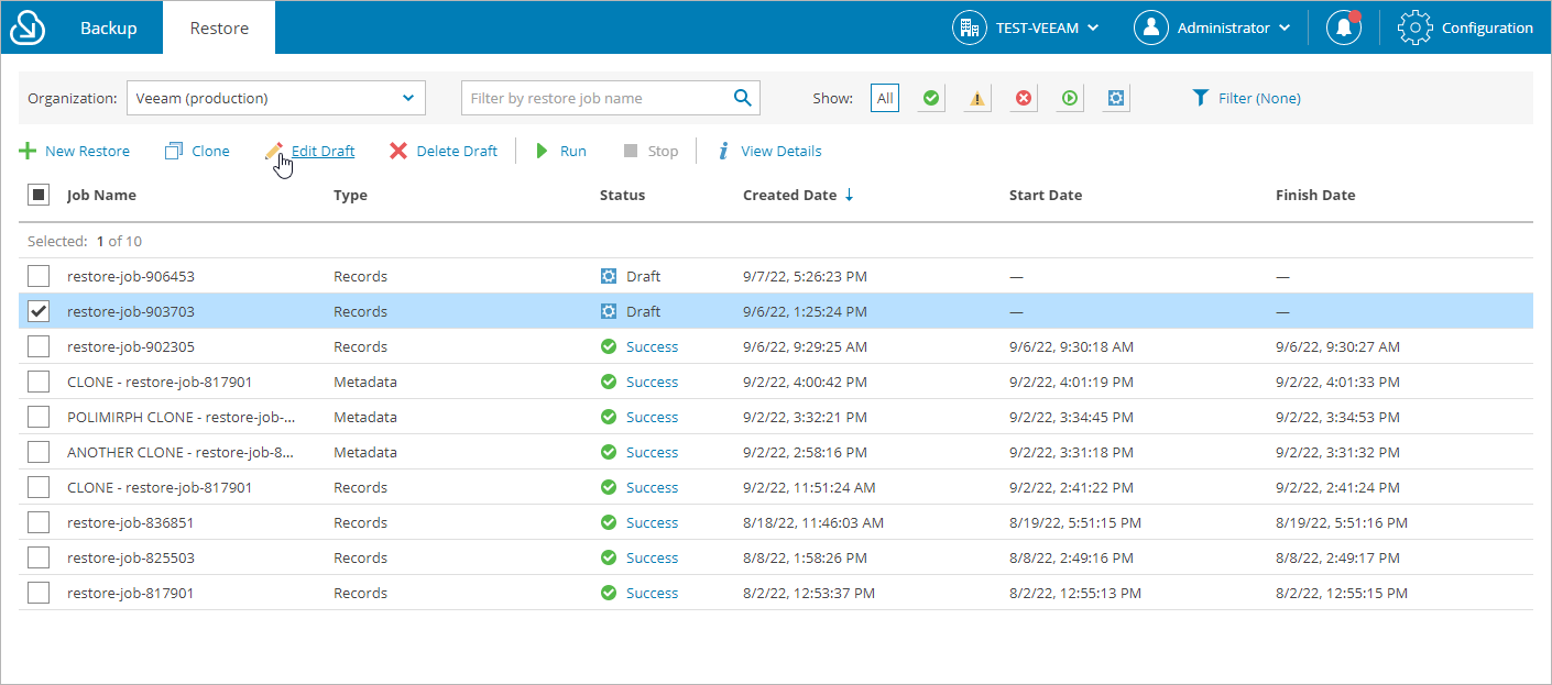

  1. Click Edit Draft. The restore job wizard will open.
  2. Edit the job settings as described in sections Restoring Records, Restoring Field Values, Restoring Files or Restoring Metadata.
