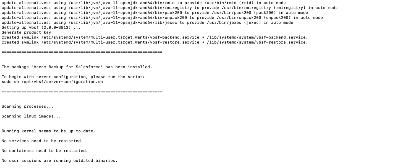

The Linux package manager will start installation of Veeam Backup for Salesforce and dependencies, and then run configuration checks.
After all configuration checks complete successfully, you will be prompted to run the server configuration script. For more information, see Configuring Server Settings.
