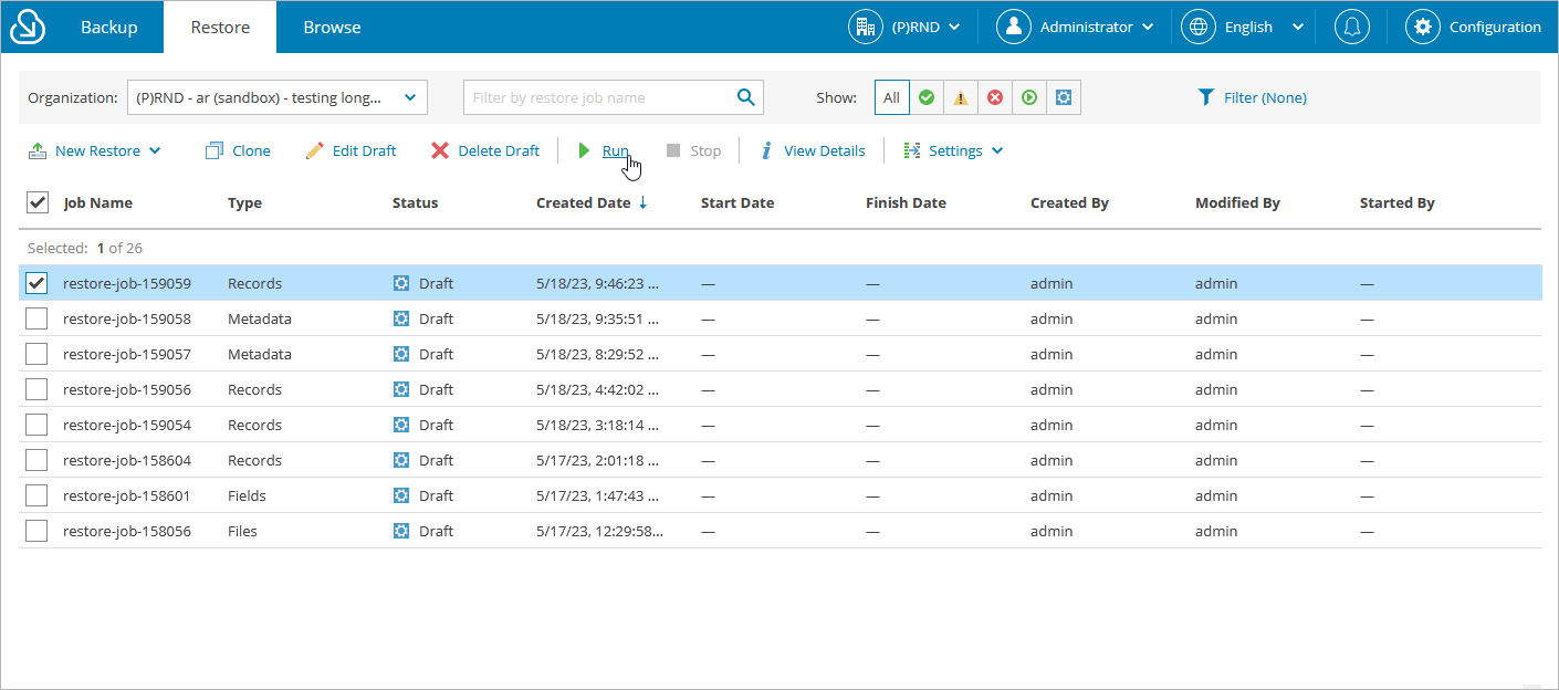

To start a restore job:
  1. Navigate to the Restore tab.
  2. From the Organization drop-down list, select a Salesforce organization for which the restore job has been created.
  3. Select the necessary job.
You can filter restore jobs displayed on the Restore tab by using the icons in the Show field at the top of the list. If you set a filter, the settings apply to all companies and do not change during the current user session. That is why if you do not see the necessary job in the list, make sure that the All filter is set.
  1. Click Run.
