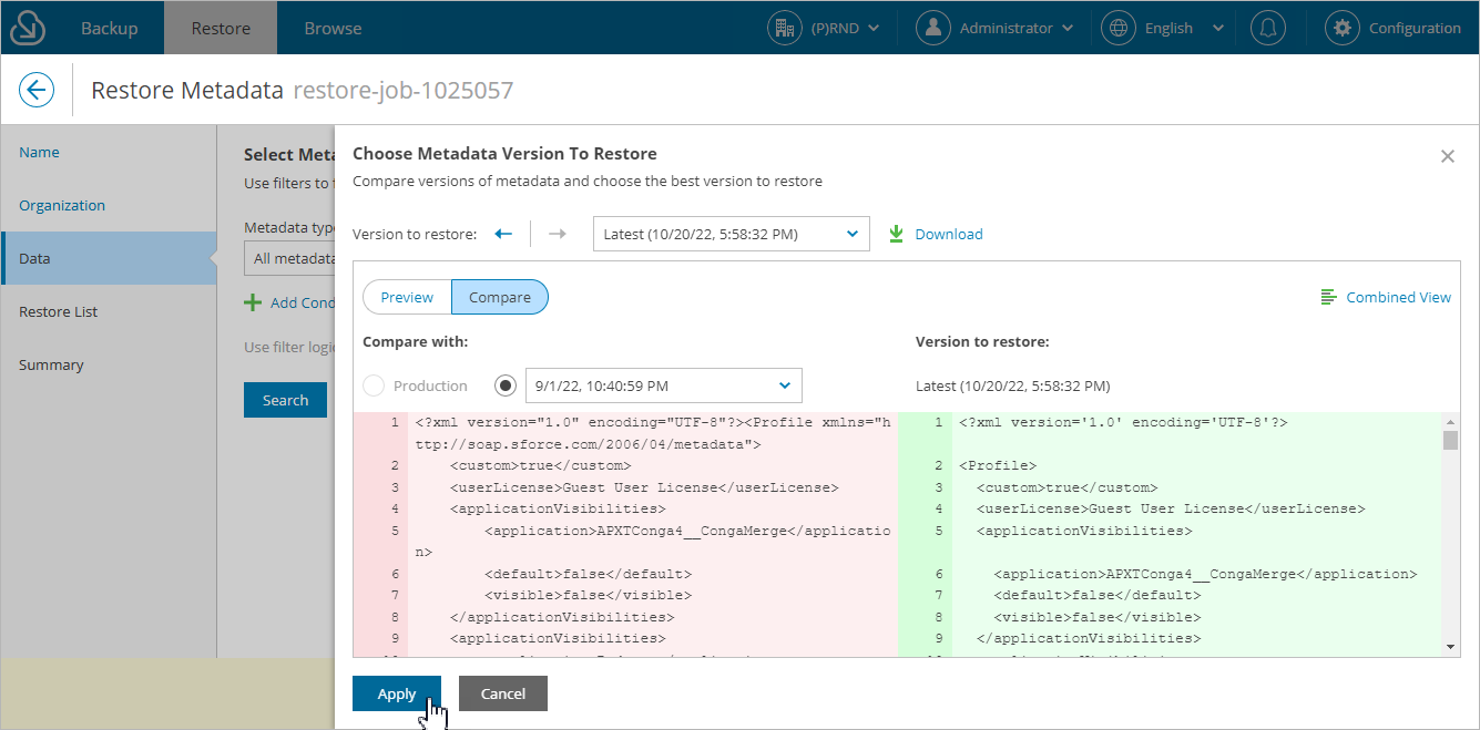

  2. To choose the version of a metadata file that will be restored, click the link in the Version column, and in the Choose Metadata Version to Restore window, compare the latest version of the backed-up metadata file with previous backed-up file versions and the version of the file currently stored in the Salesforce database, and select the necessary version.
If you are restoring a removed metadata object, make sure that you choose the previous correct version of the file. By default, files are restored to the latest version.
