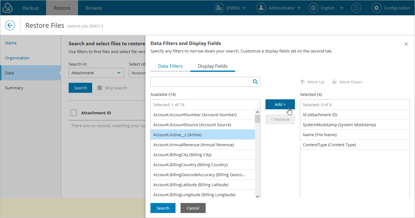

  1. The results will be shown in the table with the columns that match specific Salesforce fields. To choose the displayed information, click Customize and select the necessary Salesforce fields on the Display Fields tab in the Data Filters and Display Fields window.
