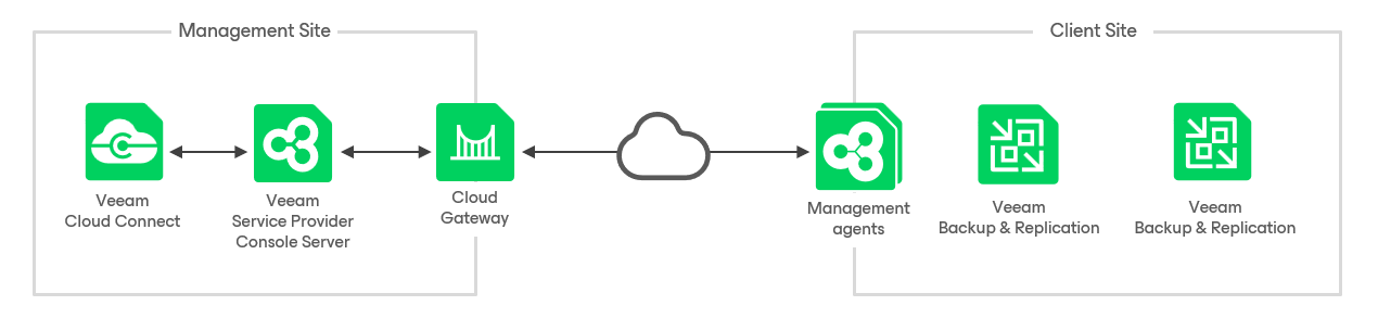

Managing Veeam Backup & Replication servers and allocating Veeam Cloud Connect resources in Veeam Service Provider Console requires an environment with two logical sites:
  • The management site, where Veeam Service Provider Console is deployed and the Veeam Cloud Connect resources are hosted.
  • The client site, where client virtual and Veeam Backup & Replication infrastructures reside.
The management and client sites normally belong to different networks, separated by WAN links. However, for trial purposes, these sites can be parts of the same network.

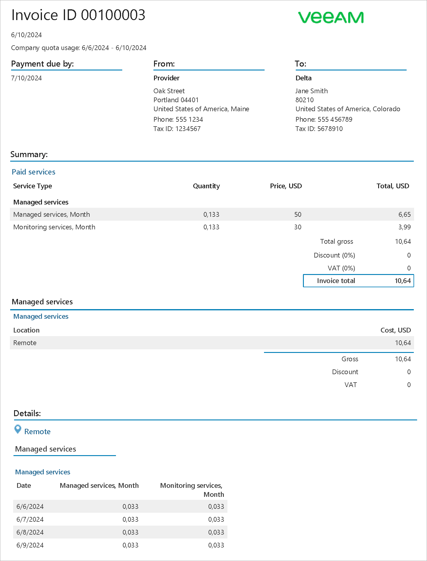

Creating Invoice
You can generate an invoice in the Veeam Service Provider Console to calculate the cost of services provided to a company. The invoice provides information about the cost of consumed services in accordance with a subscription plan assigned to a company.
From the Veeam Service Provider Console, you can send an invoice to a client company by email. Invoices are sent as PDF files attached to billing notifications. You can also configure a schedule according to which invoices will be generated to automate invoicing.
Invoice Example
For more information about working with invoices, see section Managing Invoices in the Guide for Service Providers.
