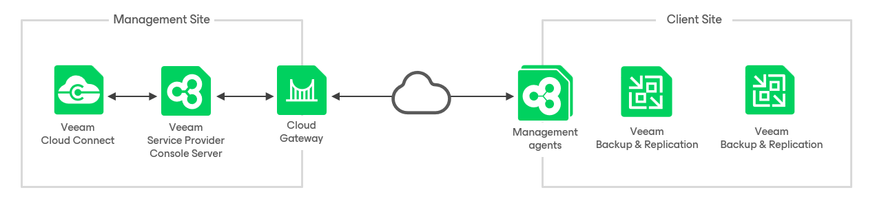

Managing Veeam Backup & Replication servers and allocating Veeam Cloud Connect resources in Veeam Service Provider Console requires an environment with two logical sites:
  • The management site, where Veeam Service Provider Console is deployed and the Veeam Cloud Connect resources are hosted.
  • The client site, where client virtual and Veeam Backup & Replication infrastructures reside.
The management and client sites normally belong to different networks, separated by WAN links. However, for trial purposes, these sites can be parts of the same network.
Reference Environment
To manage a Veeam Backup & Replication server in the client infrastructure in Veeam Service Provider Console, you must ensure that the server is connected to Veeam Service Provider Console. You can connect a Veeam Backup & Replication server with the following methods:
  • Install Veeam Backup & Replication server on discovered computers in the client infrastructure using Veeam Service Provider Console.
You can install Veeam Backup & Replication on discovered computers in the client infrastructure. If a Veeam Service Provider Console management agent is not installed on the computer, it will be deployed during the installation. For details, see section Installing Veeam Backup & Replication in the Guide for Service Providers.
  • Connect a Veeam Backup & Replication server in the client infrastructure to Veeam Service Provider Console.
You can enable the option to allow service providers to manage a Veeam Backup & Replication installation in the Veeam Backup & Replication console. Enabling this option deploys the Veeam Service Provider Console management agent on the Veeam Backup & Replication server. For details, see section Connecting Veeam Backup & Replication Servers in the Guide for Service Providers.

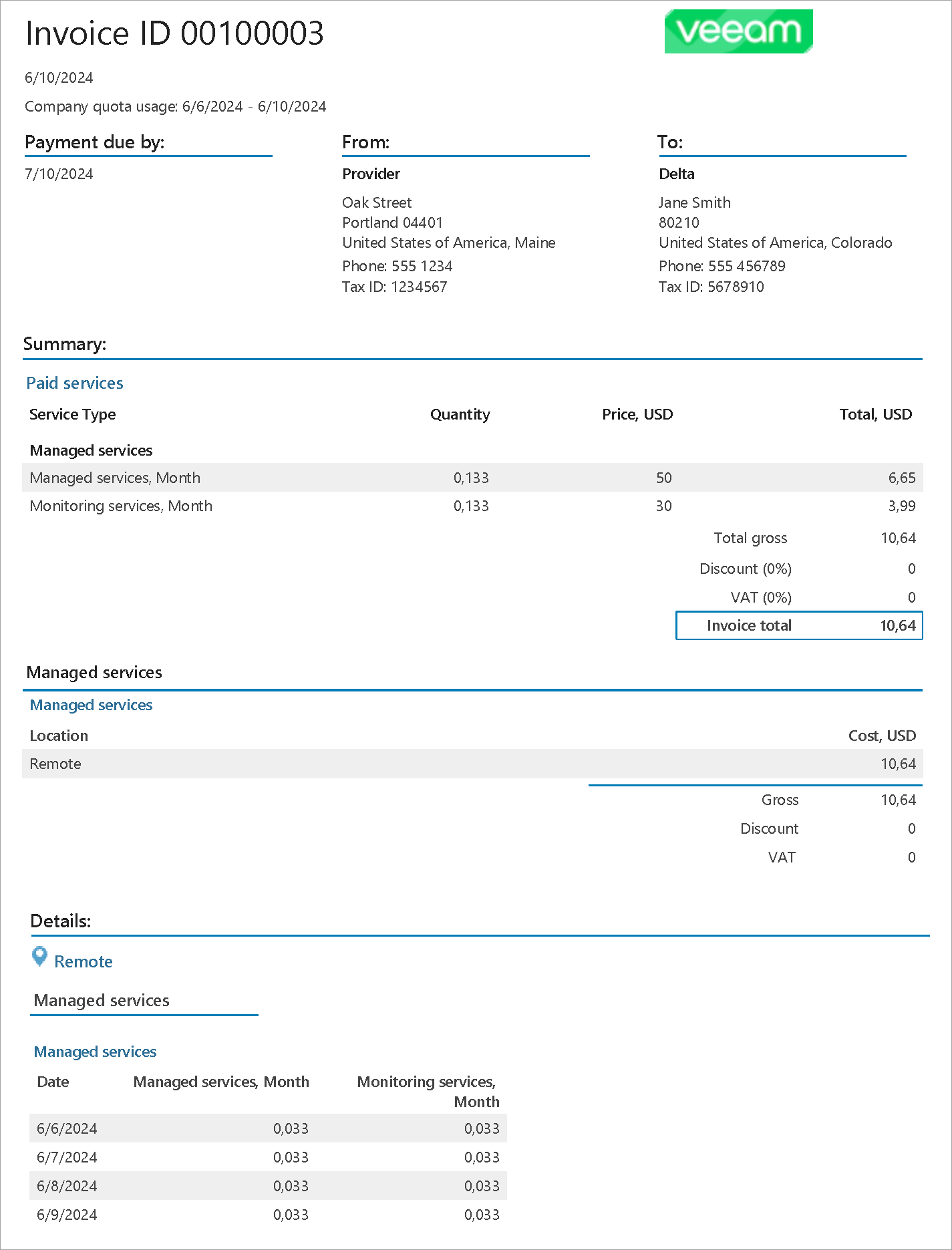

Creating Invoice
You can generate an invoice in the Veeam Service Provider Console to calculate the cost of services provided to a company. The invoice provides information about the cost of consumed services in accordance with a subscription plan assigned to a company.
From the Veeam Service Provider Console, you can send an invoice to a client company by email. Invoices are sent as PDF files attached to billing notifications. You can also configure a schedule according to which invoices will be generated to automate invoicing.
Invoice Example
For more information about working with invoices, see section Managing Invoices in the Guide for Service Providers.
