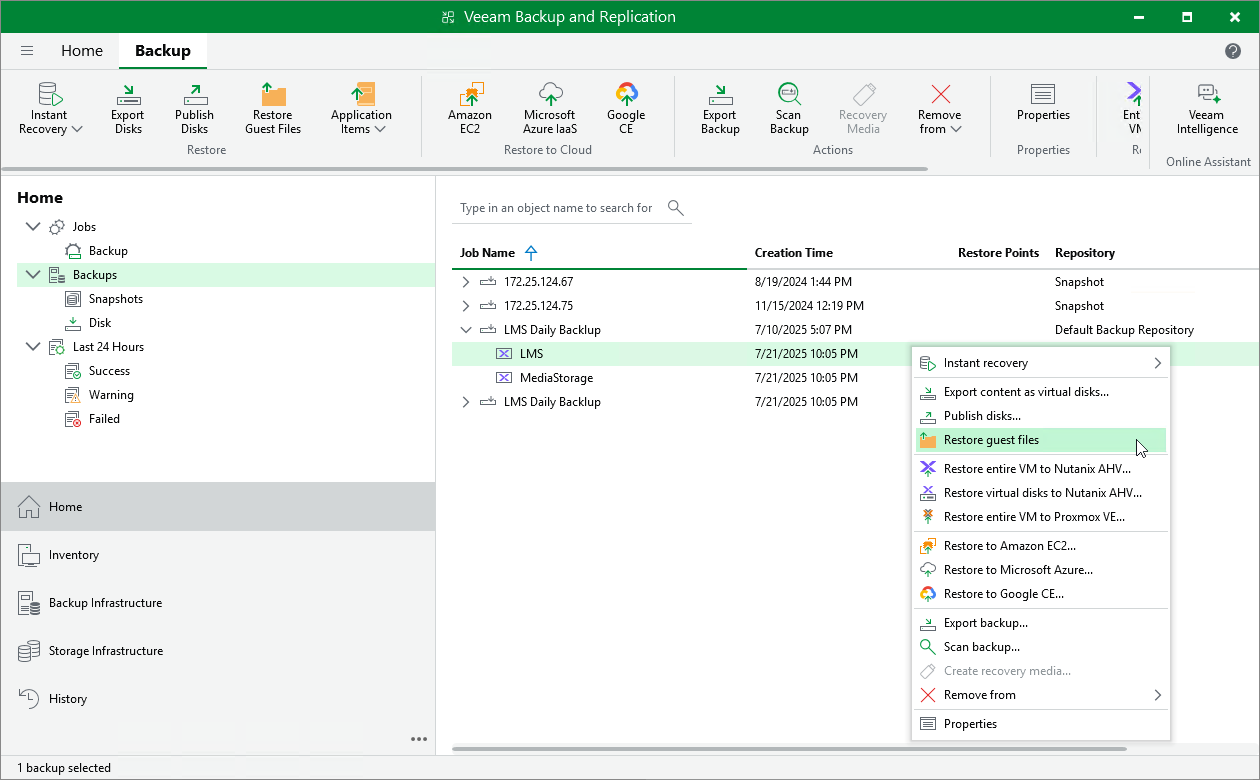

To restore VM guest OS files and folders, do the following:
  3. In the working area, expand the necessary backup or snapshot job, right-click the VM that contains files you want to restore and and complete the File Level Restore wizard as described in the Veeam Backup & Replication User Guide, section Recovering Guest OS Files Using Console.
Depending on the operating system of a VM whose files and folders you want to restore, Veeam Backup & Replication may require a mount host — a server that will be used to mount VM disks. While completing the Guest File Restore wizard, you will be able either to choose a server already added to the backup infrastructure or to specify connection settings of a new server that will used as the mount host. For more information on how Veeam Backup & Replication selects mount hosts, see the Veeam Backup & Replication User Guide, section Mount Host Automatic Selection.
