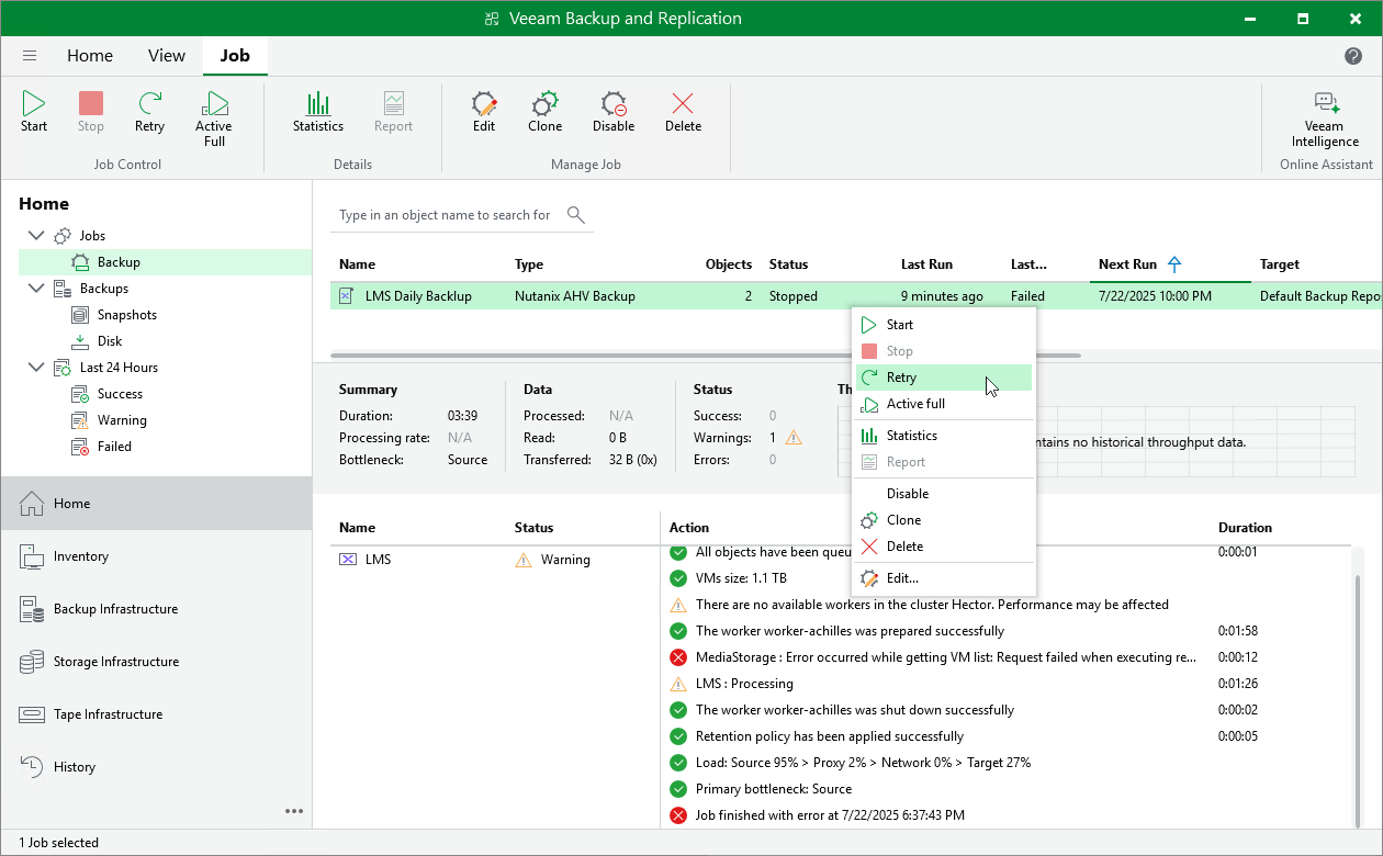

If a job fails, you can retry the backup operation. When you perform a retry, Veeam Backup & Replication restarts the operation only for the failed resources added to the job and does not process VMs that have been processed successfully. As a result, retrying a job takes less time compared to restarting the job for all resources.
To retry a job, do the following:
  1. Open the Home view.
  3. In the working area, select the necessary job and click Retry on the ribbon.
Alternatively, right-click the job and select Retry.
Retrying Job
