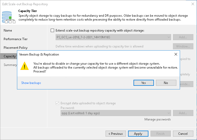

To exclude a capacity extent from the scale-out backup repository scope, do the following:
  2. In the inventory pane, click Scale-out Repositories.
  3. In the working area, select a scale-out backup repository and click Edit Scale-out Repository on the ribbon, or right-click a scale-out backup repository and select Properties.
  4. Move to the Capacity tier step of the wizard.
  5. Clear the Extend scale-out backup repository capacity with object storage check box.
You will be asked to confirm the action in the pop-up dialog. After that, the object storage repository will be immediately put into the maintenance mode.
