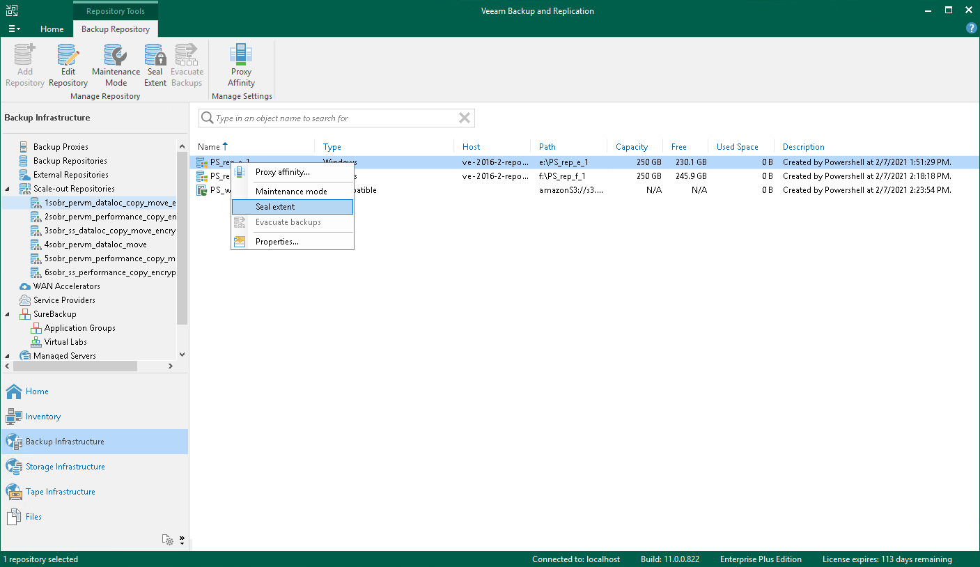

To put a performance extent into the seal mode:
  2. In the inventory pane, select the scale-out backup repository under the Scale-out Repositories node.
  3. In the working area, select a performance extent and click Seal Mode on the ribbon or right-click an extent and select Seal mode.
To remove the extent from the seal mode, select the extent and click Sealed on the ribbon or right-click the extent and select Sealed.
