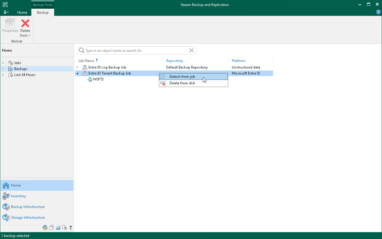

To detach backups from a job:
  1. Open the Home view.
  2. In the inventory pane, select the Backups node.
  3. In the working area, right-click the necessary backup and select Detach from job. Alternatively, click Delete from > Job on the ribbon.
Detach Backup from Job
