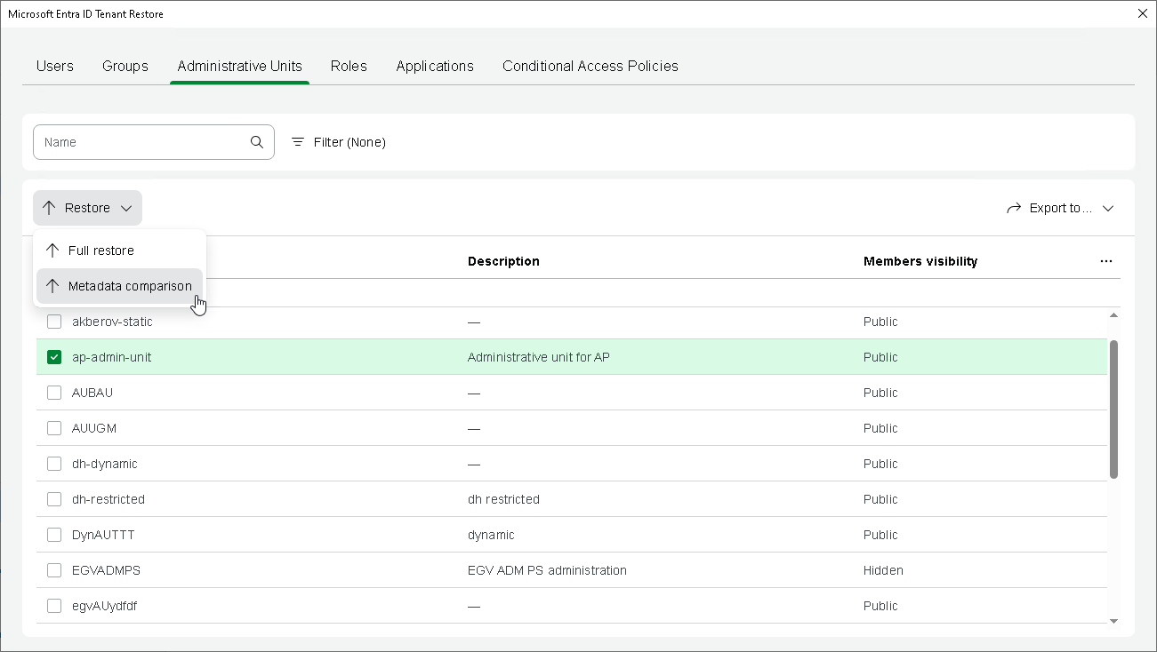

  5. In the opened window, check that the Administrative Units tab is selected.
  6. Select the administrative unit whose properties you want to restore.
To find an administrative unit by its display name, use the search field.
  1. Click Restore > Metadata comparison. Alternatively, right-click the selected administrative unit and select Restore > Metadata comparison.
Launch Properties Restore Wizard
