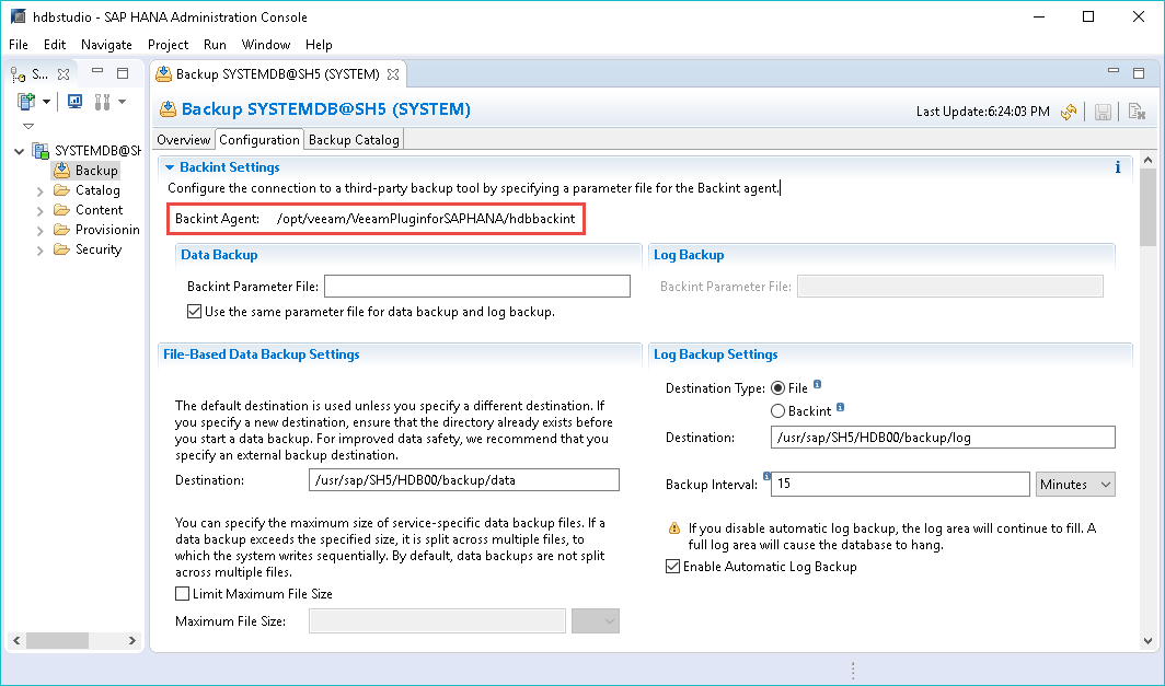

Verifying Configuration of Veeam Plug-in for SAP HANA
When you finish the plug-in configuration wizard, the plug-in creates a soft link in /hana/shared/<SID>/global/hdb/opt.
To verify the Backint configuration, do the following:
- Connect to the database using SAP HANA Studio or Cockpit.
- Go to Backup/Configuration.
- In the Backint Agent field, make sure that the specified path leads to /opt/veeam/VeeamPluginforSAPHANA/hdbbackint.
