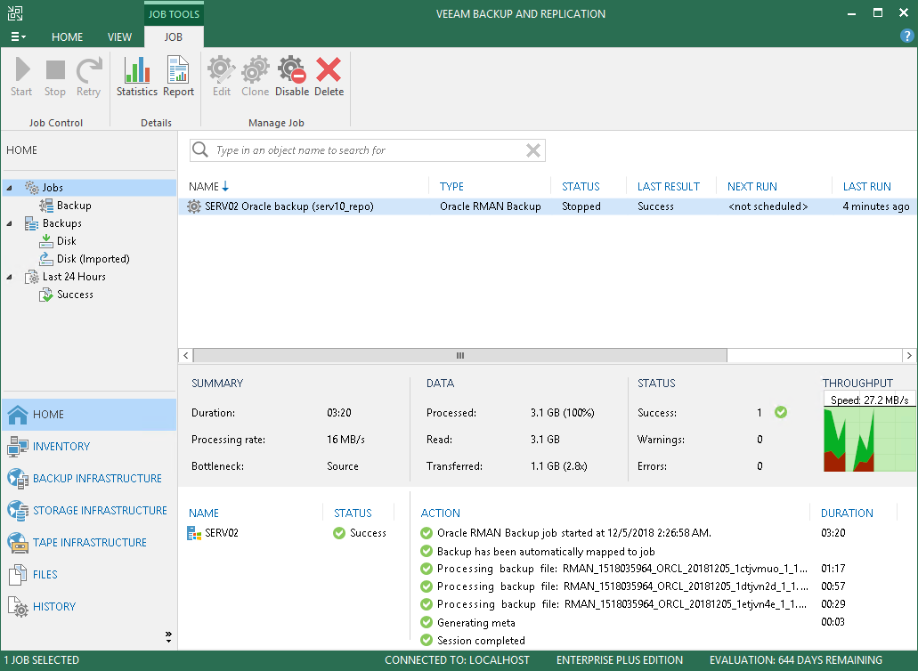

Backup Job in Veeam Backup & Replication Console
After you launch a backup process in Oracle RMAN, Veeam Backup & Replication creates a backup job. To see the progress of the backup job:
- Open the Veeam Backup & Replication console.
- In the Home view, expand the Jobs node and click Backup.
If you click the backup job, you can view the details of the backup process.
