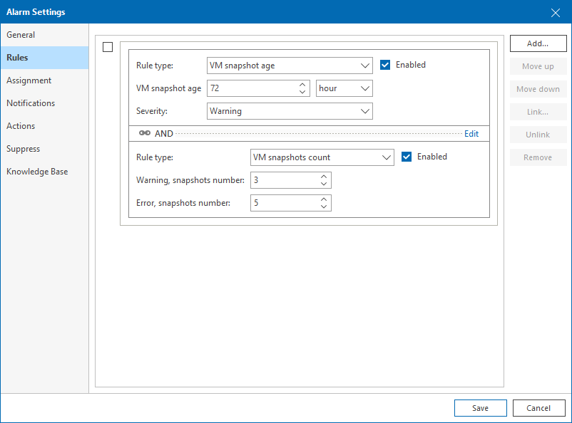

  1. Select check boxes next to rules you want to link, and click Link on the right.
  2. In the Rule condition window, select a condition:
  • AND — if rules are linked with this operator, the alarm is triggered when conditions for all linked rules are met.
  • OR — if rules are linked with this operator, the alarm is triggered when a condition for any of the linked rules is met.
  1. Click Apply.
After you link two or more rules, Veeam ONE will display a dotted line and a linking condition between the rules. Linking supports 3 levels of nesting.

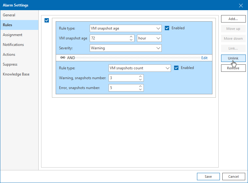

To unlink rules:
  1. Select the check box next to the linked rules.
  2. On the right, click Unlink.
If you unlink rules, the alarm will be triggered each time when conditions for any alarm rule are met.
