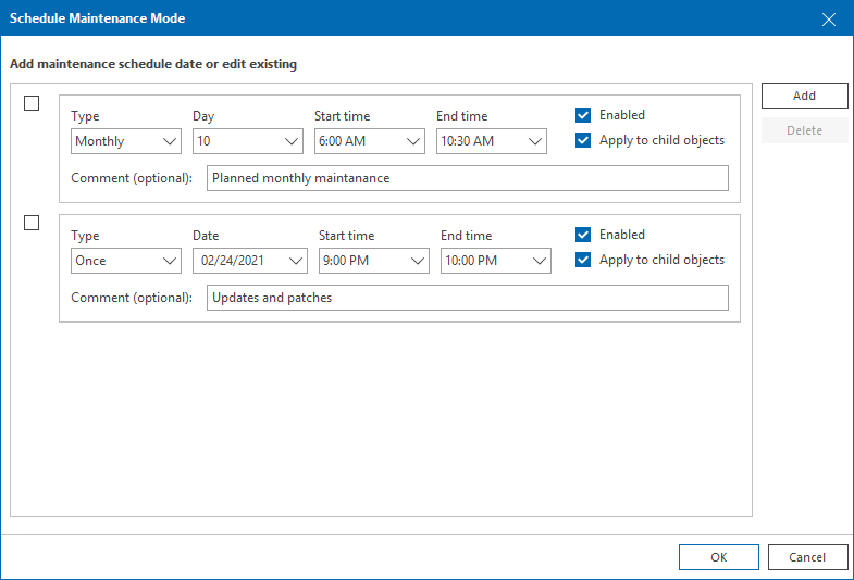

Scheduling Maintenance Mode
You can configure a maintenance schedule for infrastructure objects. When a schedule is set, the maintenance mode will be enabled and disabled automatically according to the schedule.
To configure a maintenance schedule:
- Open Veeam ONE Client.
For details, see section Accessing Veeam ONE Client of the Veeam ONE Client User Guide.
- At the bottom of the inventory pane, click the necessary view — Infrastructure View, Business View, vCloud Director View, or Data Protection View.
- In the inventory pane, right-click an infrastructure object and choose Schedule Maintenance Mode from the shortcut menu.
- In the Schedule Maintenance Mode window, configure the maintenance schedule.
- Click Add.
- In the Type field, specify how often the object must be placed into the maintenance mode (once, monthly, weekly, daily).
- In the Day/Date field, specify a day when the maintenance mode must be enabled.
- In the Start time and End time fields, specify the start and end time of the maintenance period.
- Select the Apply to child objects check box if you want to enable the maintenance mode on the object itself and its child objects.
- In the Comment field, provide additional information about the planned maintenance. You can enter up to 512 characters in this field.
- Select the Enabled check box to enable the maintenance schedule.
- Repeat steps a–g for each schedule entry you want to add.
- Click OK.
