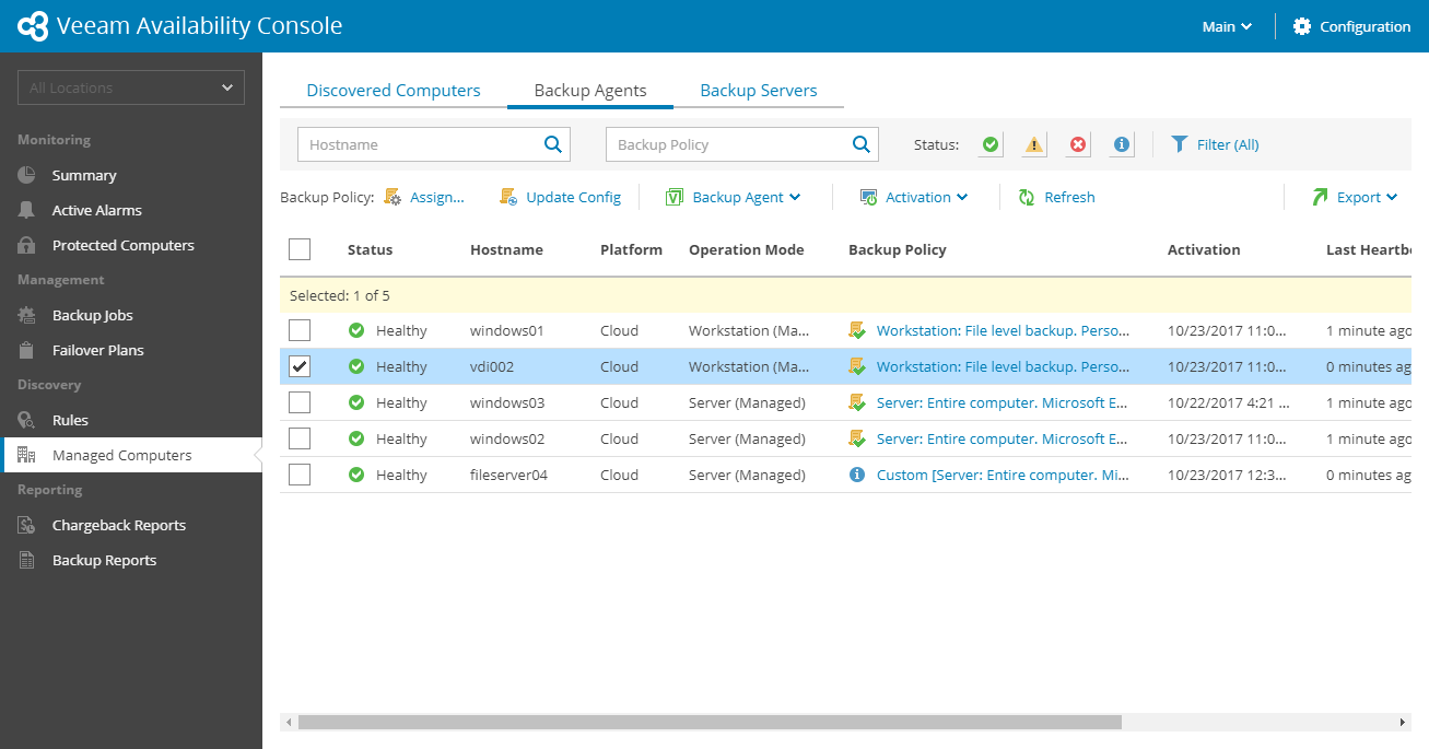

To view and export Veeam backup agent details:
  1. Log in to Veeam Availability Console.
For more details, see Accessing Veeam Availability Console.
  1. In the menu on the left, under Discovery click Managed Computers.
  2. Open the Backup Agents tab.
  3. To narrow down the list of managed Veeam backup agents, you can apply the following filters:
  • Hostname — limit the list of Veeam backup agents by the name of protected computer.
  • Backup policy — limit the list of Veeam backup agents by the name of a backup policy.
  • Status — limit the list of Veeam backup agents by the Veeam Availability Console management agent status (Healthy, Warning, Error, Info).
  • Assigned backup policy — limit the list of Veeam backup agents by the backup policy assignment status (Assigned, Not assigned, Custom, Outdated).
  • Operation mode — limit the list of Veeam backup agents by operation mode (Servers, Workstations).
  • Platform type — limit the list of Veeam backup agents by platform type (Physical, Cloud).
  • Installed license — limit the list of Veeam backup agents by mode (Activated, Free version).
  • Backup agent version — limit the list of Veeam backup agents by version (Up-to-date, Out-of-date, Attention required).
  • Department/Location — limit the list of jobs by department and location to which jobs belong. To limit the list of jobs by department and location, use filters at the top left corner of the Veeam Availability Console window.
  1. To export Veeam backup agent details, click Export and choose a format of the exported data:
  • Export CSV — choose this option to structure exported data as a CSV file.
  • Export XML — choose this option to structure exported data as an XML file.
