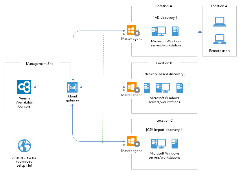

The following diagram provides a high-level pictorial overview of the discovery-based installation method.
Discovery of Client Computers
Discovery of client computers runs as follows:
- A backup administrator sets up a master agent in a department location, configures a discovery rule and initiates the discovery process.
The discovery rule describes settings required to perform discovery and (optionally) installation of Veeam backup agents on discovered computers. Discovery rule prescribes what master agent will be used for discovery, what client computers must be scanned, what account will be used to connect to these computers, whether Veeam backup agents must be installed on discovered computers, and so on.
The discovery rule can use one of the following discovery methods: network-based discovery, Active Directory discovery or import-based discovery.
- The master agent obtains from Veeam Availability Console discovery settings specified in the discovery rule. The agent connects to client computers under the specified account, collects configuration information about each scanned computer through WMI, and communicates information about discovery results to Veeam Availability Console.
Information collected from discovered computers includes details on the computer type, platform, host name, guest OS, IP address, MAC address, available applications and information about Veeam backup agent (its presence on the machine, product version and license installed).
- If the discovery rule is configured to install Veeam backup agents on discovered computers and set up a backup job, the master agent initiates these tasks after discovery.
For details on the installation process, see Installation of Veeam Backup Agents.
Installation of Veeam backup agents runs as follows:
- A backup administrator initiates the installation process.
- If a discovery rule is configured to install Veeam backup agents on discovered computers and set up a backup job, the installation process is initiated automatically after discovery. The backup administrator must only initiate the discovery process.
- Otherwise, the backup administrator must instruct Veeam Availability Console to install Veeam backup agents on discovered computers.
- The master agent downloads the Veeam backup agent setup file from the Veeam Installation Server (over the Internet), and uploads this file to discovered computers.
- The master agent downloads the Veeam Availability Console management agent setup file from the Veeam Availability Console server, uploads this file to discovered computers, triggers management agent installation, and configures management agents to communicate with Veeam Availability Console.
- Veeam Availability Console management agents on the discovered computers trigger installation of Veeam backup agents.
- When installation completes, management agents activate Veeam backup agents.
- If a backup job must be set up as part of the installation procedure, management agents apply a backup policy.
