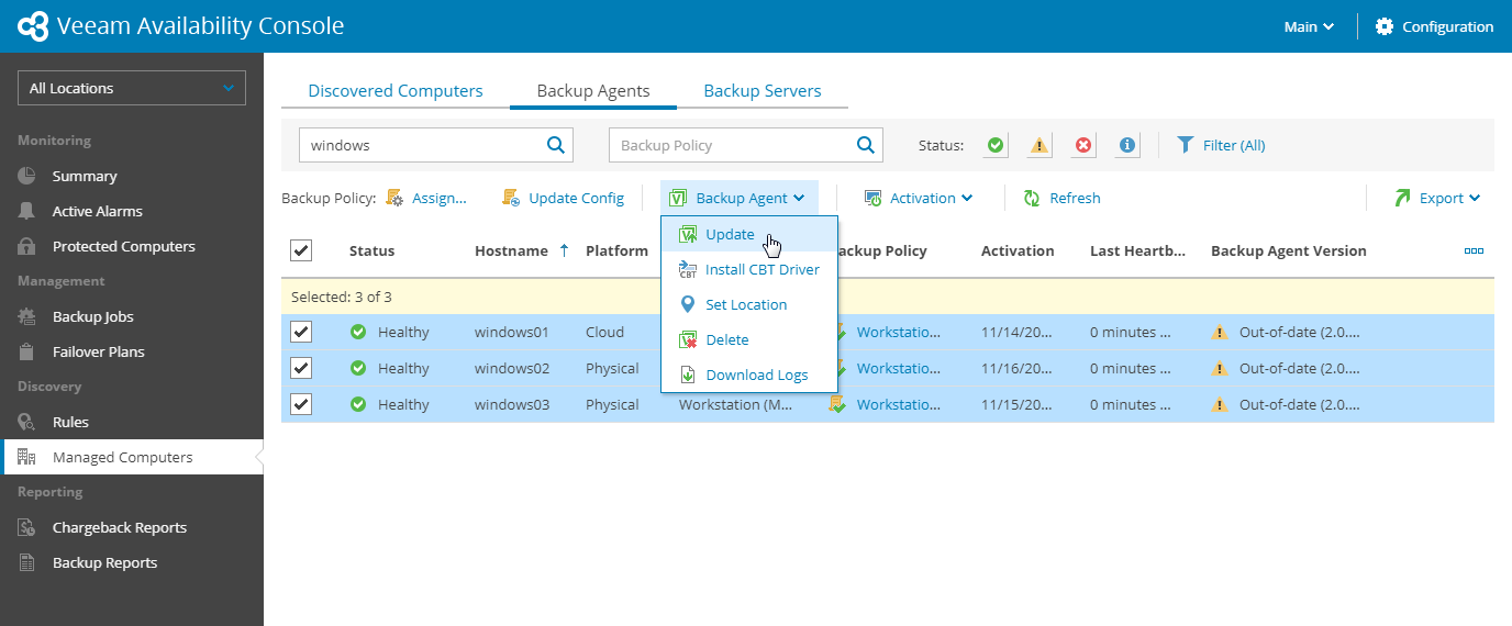

- In the menu on the left, under Discovery click Managed Computers.
- Open the Backup Agents tab.
- Select one or more Veeam backup agents in the list.
- At the top of the list, click Backup Agent and choose Update.
After you initiate the update procedure, the value in the Backup Agent Version column will be changed to Updating. You can click the Updating link to track the progress of the update procedure.
- Check the value in the Backup Agent Version column.
After the update procedure completes, the value in this column will be set to Up-to-date.
