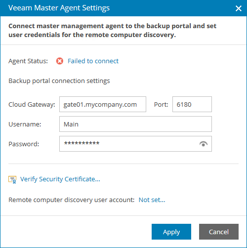

To configure a master agent:
- In the icon tray, right-click the master agent icon and choose Agent Settings.
If the icon is hidden, display hidden icons, find Veeam.MBP.Agent.Configurator in the list of notification area icons, and choose to show the icon and notifications for it.
- In the Veeam Master Agent Settings window, specify settings that the agent must use to connect to Veeam Availability Console.
- In the Cloud Gateway field, type FQDN or IP address of a cloud gateway.
- In the Port field, specify the port on the cloud gateway that is used to transfer data to Veeam Availability Console.
- In the Username and Password fields, type user credentials of a Department Owner.
- In the Veeam Master Agent Settings window, click Apply.
- In the displayed window, click Yes to restart the management agent.
- Wait for the agent to connect to Veeam Availability Console.
When the agent connects to Veeam Availability Console, the status in the Veeam Master Agent Settings window will be displayed as Connected. The agent icon in the icon tray will turn blue.
