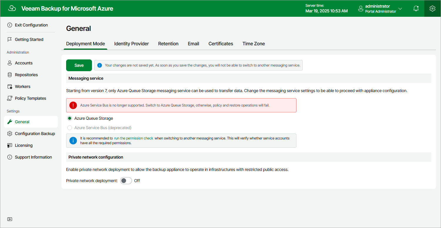

To enable the private network deployment functionality, do the following:
  1. Switch to the Configuration page, navigate to General > Deployment Mode and set the Private network deployment toggle to On.

[Applies only to upgraded appliances that still use Azure Service Bus as a messaging service]
Veeam Backup for Microsoft Azure uses a messaging service to allow communication between the architecture components. In versions prior to 7.0, Veeam Backup for Microsoft Azure used the Azure Service Bus messaging service by default. In version 7.0, Azure Service Bus was replaced by Azure Queue Storage. That is why you must manually switch to the Azure Queue Storage service immediately after you upgrade the backup appliance — otherwise, Veeam Backup for Microsoft Azure will fail to perform backup and restore operations. For more information on the Azure Queue Storage messaging service, see Microsoft Docs.
After you switch to the Azure Queue Storage service, you must do the following:
  1. Check whether service accounts have all the permissions required to use this service, as described in section Checking Service Account Permissions.
