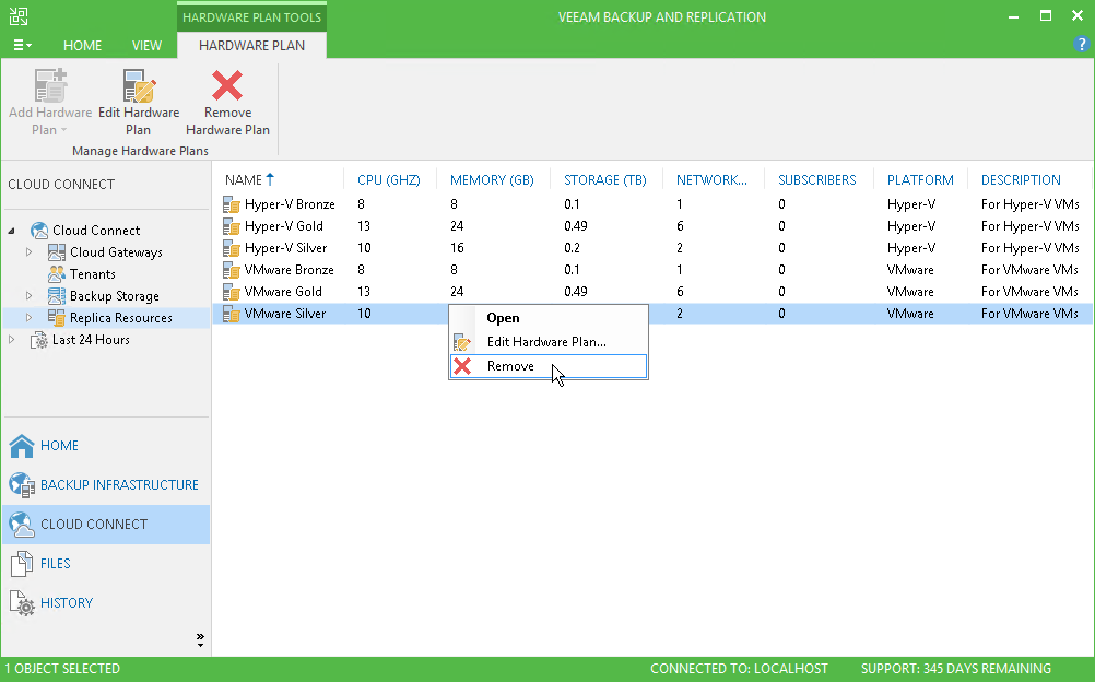

To remove a hardware plan:
- Open the Cloud Connect view.
- Do one of the following:
- In the inventory pane, click the Replica Resource node, select the necessary hardware plan in the working area and click Remove Hardware Plan on the ribbon or right-click the necessary hardware plan and select Remove.
- In the inventory pane, expand the Replica Resource node, select the necessary hardware plan in the inventory pane and click Remove Hardware Plan on the ribbon or right-click the necessary hardware plan and select Remove.
