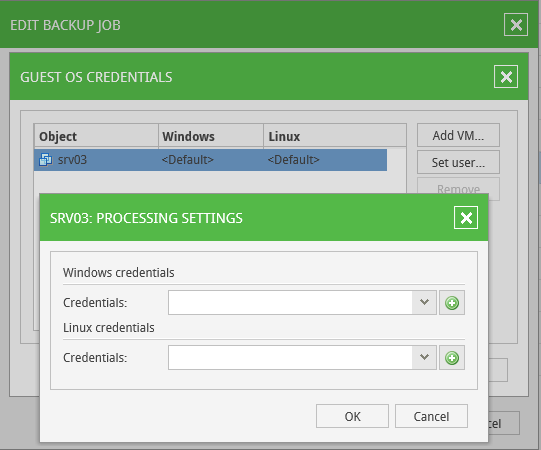

Special Credentials for Machine
By default, for all machines in the list Veeam Backup & Replication uses common credentials you provided in the Guest OS credentials section.
- If a different account should be used to deploy the agent inside a specific machine, select the machine in the list, click Set User button and enter custom guest OS credentials.
- To discard custom credentials for a machine, select it in the list and click the Remove button.
To customize settings of a machine added to the job as part of a container, the machine should be included in the list as a standalone instance. For that, click Add Machine and choose a machine whose settings you want to customize. |
