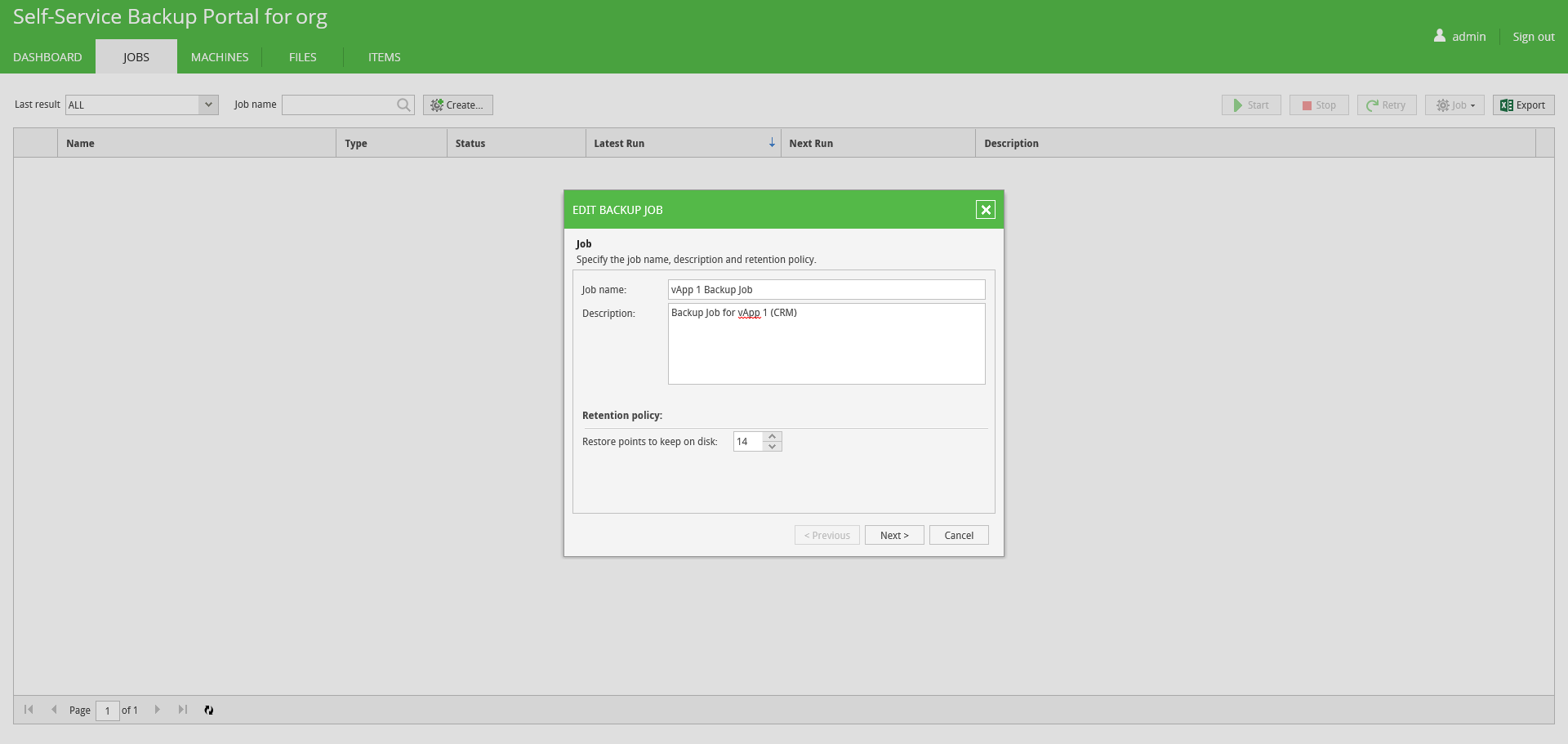

Creating a Job
To create a new vCloud Director backup job:
- Go to the Jobs tab of the self-service web portal and click Create.
- Specify job name, description and retention settings, that is, how many restore points should be stored in repository for future restores.
For details, refer to this section of the User Guide.
