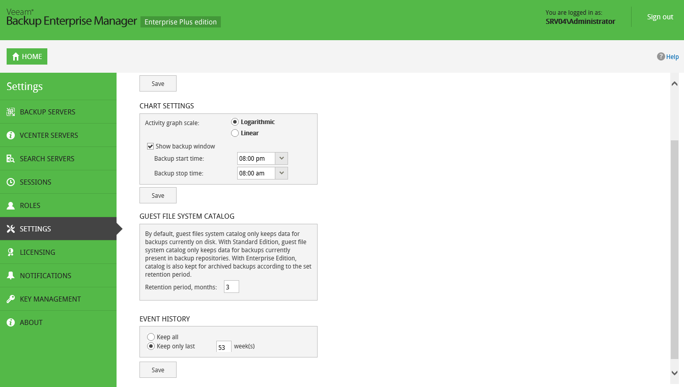

Customizing Dashboard Appearance
If required, you can customize the appearance of graphs in the main Veeam Backup Enterprise Manager view. Do the following:
- Open the Configuration view.
- Click the Settings tab on the left of the Configuration view.
- Use the Activity graph scale options in the Chart Settings section to switch between graph types: Linear and Logarithmic.
- By default, the time interval specified under the selected Show backup window check box is highlighted on the activity graph. Default interval is from 8:00 PM to 8:00 AM. You can change the highlighted interval to correlate with your planned backup window by editing the start and stop time. If you do not want to highlight the backup window on the graph, clear the Show backup window check box.
- Save the changes.
