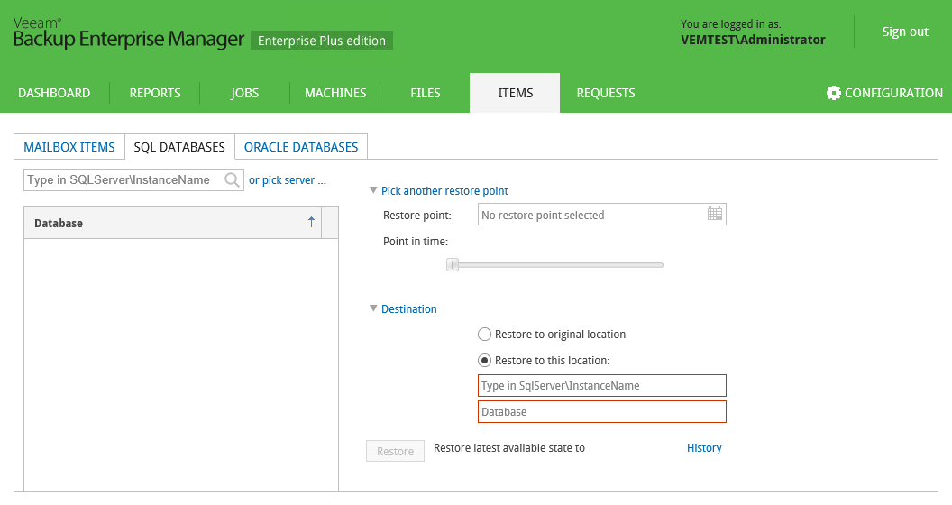

Alternatively, you can carry out the restore procedure with custom settings, specifying the restore point and destination location you need. Do the following:
- If necessary, use the link to Pick another restore point.
- For database backed up with transaction log backup turned on, you can also select the necessary point in time using the timeline.

- To specify target SQL server database, click the Destination link. Specify the location where you want the database items to be restored: enter sql_server_name\instance_name and database_name.
