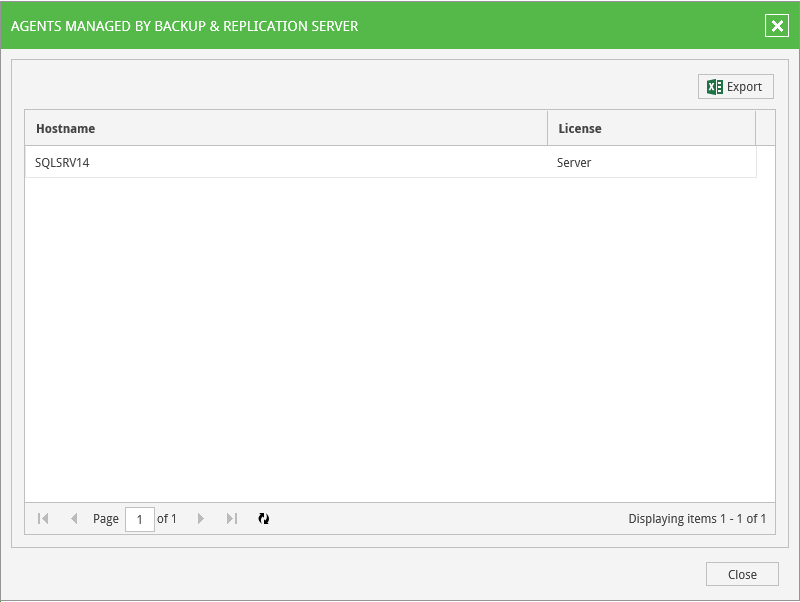

Here you can install a new license for Veeam Agent(s), view detailed license information and examine the list of Veeam backup servers managing the licensed Agents.
- To view the list of Agents working with the certain Veeam backup server, select this server from the list in the bottom of the pane and click View Agents. The displayed list of managed agents includes information about Veeam backup server and type of license (Server or Workstation).
- To download the list as the excelreport.xls file, click Export, then close the dialog.
