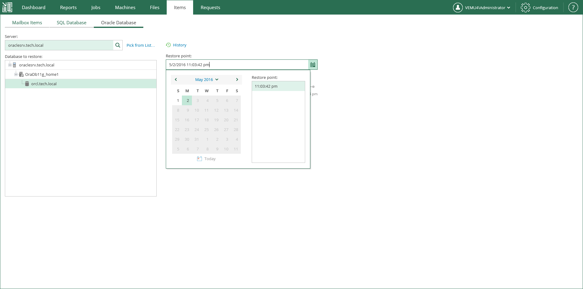

Alternatively, you can carry out the restore procedure with custom settings, specifying the restore point and destination location you need. Do the following:
- If necessary, click the link to Pick another restore point. Use the calendar control to choose from the available dates when restore points were created — they are marked with blue square outline; if more than one restore point per day was created, select the required time on the right.
- If you backed up archived redo logs for the database, you can also select the required Point in time using the timeline and the slider.
