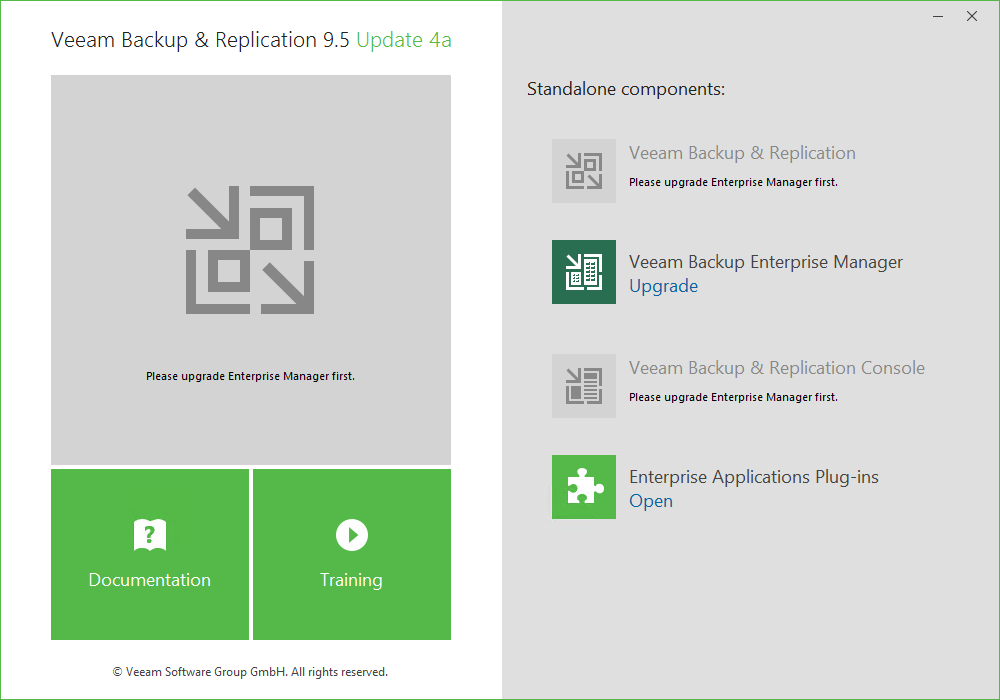

    2. Mount the product ISO and use autorun, or run the Setup.exe file.
    3. Click Upgrade Veeam Backup Enterprise Manager.
    4. Follow the setup wizard steps. At the SQL Server Instance step, select the SQL server, instance and database that was used by the previous version of Veeam Backup Enterprise Manager.
