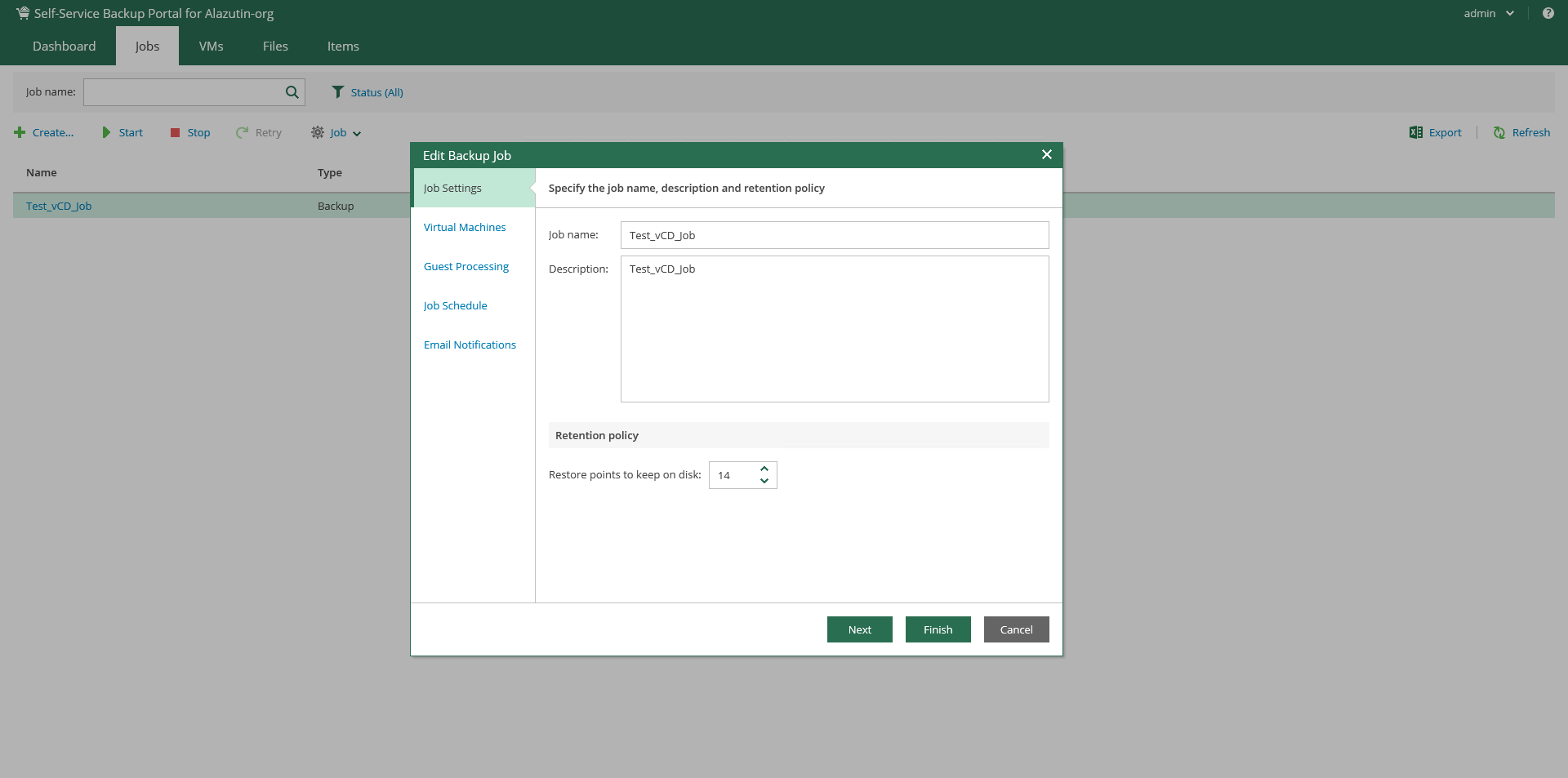

To create a new vCloud Director backup job:
- Go to the Jobs tab of the Self-Service Backup Portal and click Create.
- Specify job name, description and retention settings, that is, how many restore points should be stored in repository for future restores.
