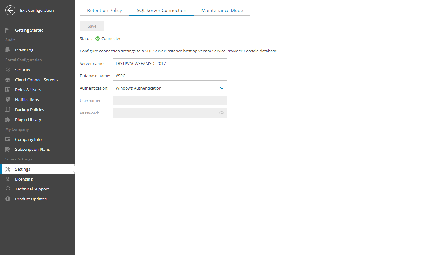

To change SQL Server connection settings, perform the following steps:
  2. In the configuration menu on the left, click Settings.
  3. Open the SQL Server Connection tab.
  4. In the Server name field, specify a name of a Microsoft SQL Server instance that hosts the Veeam Service Provider Console database.
  5. In the Database name field, specify a name of the Veeam Service Provider Console database.
  6. From the Authentication list, select the type of authentication that Veeam Service Provider Console must use to connect to the Microsoft SQL Server.
  7. [For SQL Server Authentication] In the User name and Password fields, specify credentials of the account that Veeam Service Provider Console must use to connect to the Microsoft SQL Server.
  8. Click Save.

  1. In the Settings section open the SQL Server Connection tab.
  2. Specify settings for connecting to an existing or a new database as described in Configuring SQL Server Connection Settings.
