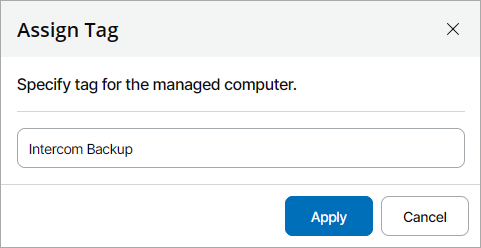

To assign custom tags to managed Veeam Backup & Replication servers:
  2. Open the Backup Servers tab.
  3. Select a Veeam Backup & Replication server in the list.
  4. Click a link in the Tag column.
If the column is hidden, click the ellipsis on the right of the list header and select Tag in the list of properties that must be displayed.
  1. In the Assign Tag window, specify a tag that must be assigned to a backup server and click Apply.
