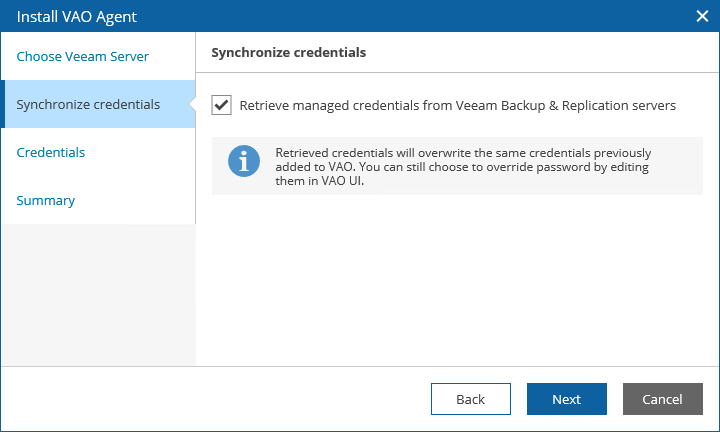

  1. At the Synchronize Credentials step, choose whether you want to retrieve credentials from the connected Veeam Backup & Replication server. You will be able to use these credentials later when configuring orchestration plan steps.
Connecting Veeam Backup & Replication Server

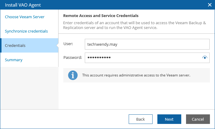

  1. At the Credentials step, in the User and Password fields, specify credentials of a user account for connecting to the server. The provided credentials will be also used to launch the Veeam Orchestrator Agent on the server.
The user name should be specified in the DOMAIN\USERNAME format.
