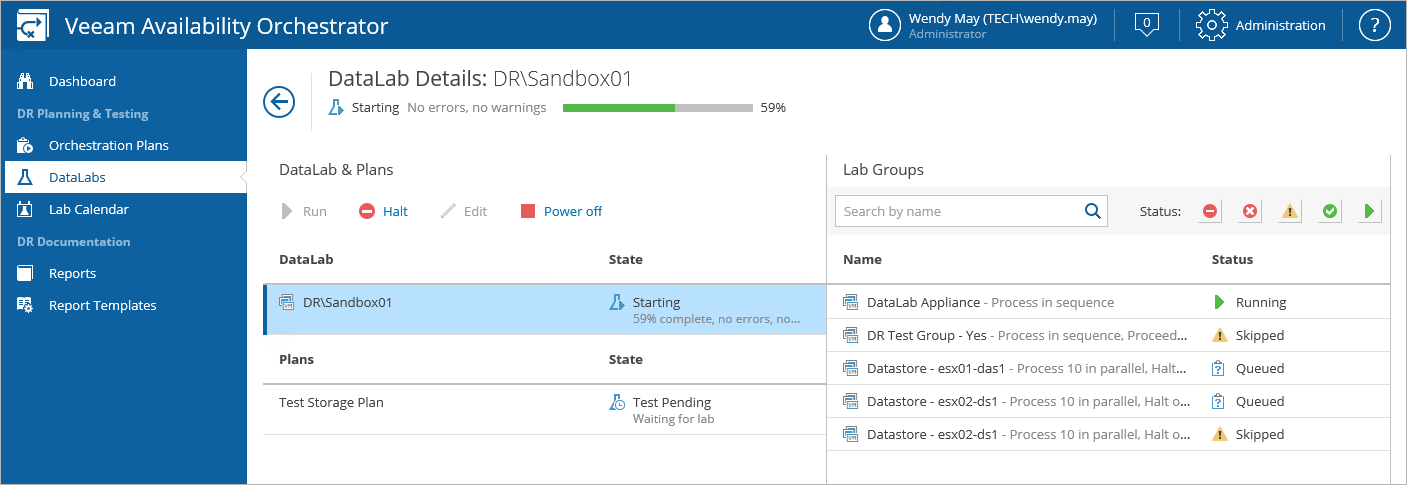

  2. Navigate to DataLabs. In the DataLabs column, click the lab name.

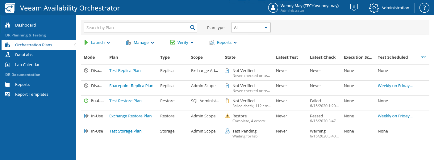

Navigate to Orchestration Plans and click the name of the plan being tested.

The DataLab Details page will display real-time testing details. To track testing progress for VM groups, VMs and steps in the orchestration plan, click the plan name.
The plan will enter the TEST PENDING state until the lab and all lab groups are started.
Tracking On-Demand Plan Test Details
Test verification results will be displayed on the Orchestration Plans page, in the Latest Test and State columns.
