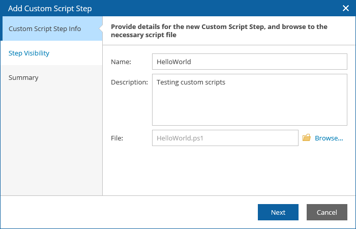

  1. At the Custom Script Step Info step, fill out the Name and Description fields, and browse to the script file.
Creating Custom Script Step

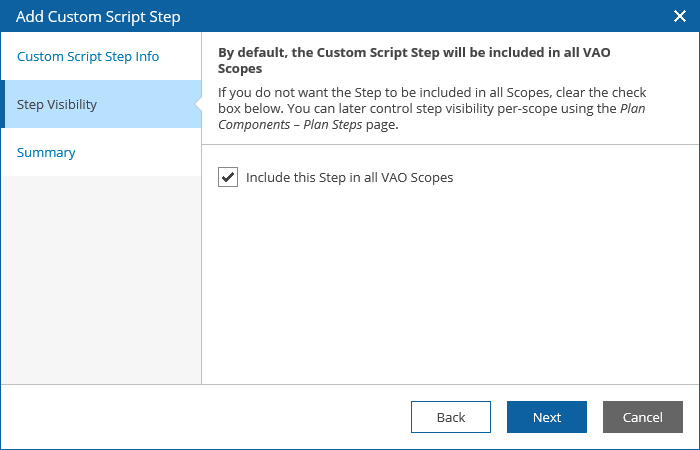

  1. At the Step Visibility step, use the Include this Step in all VAO Scopes check box to choose whether users of any scope will be able to use the script when creating and launching orchestration plans.
If you do not select the Include this Step in all VAO Scopes check box, you can enable the script on a per-scope basis. For more information on managing plan steps, see Configuring Veeam Availability Orchestrator.
