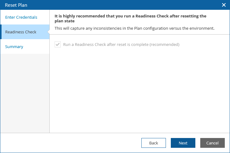

    Resetting Storage Plan
    1. At the Readiness Check step, click Next.
    Due to technical reasons, VAO will anyway run a readiness check to confirm that the changes are valid after reset is complete.
