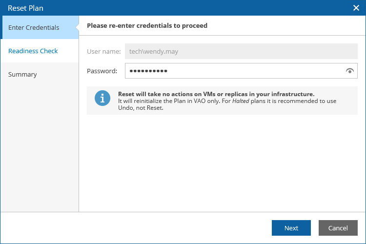

  1. Complete the Reset Plan wizard:
  1. For security purposes, at the Enter Credentials step, retype the VAO Administrator, Plan Author or Plan Operator password.

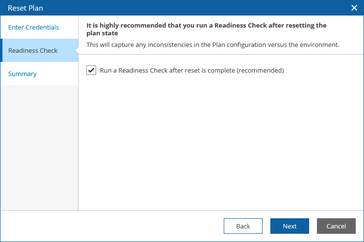

  1. At the Readiness Check step, select the Run a Readiness Check after reset is complete check box to run a readiness check to confirm that the changes are valid.
