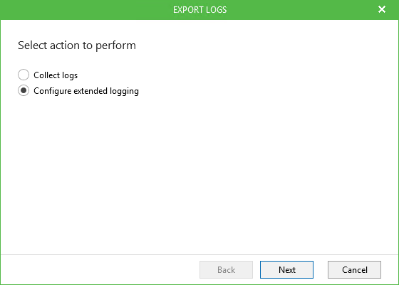

To configure extended logging mode, do the following:
- Go to the main menu and click Help and Support > Support Information.
- Select Configure extended logging.
- Select components (local or remote) to which you want to apply extended logging mode.
