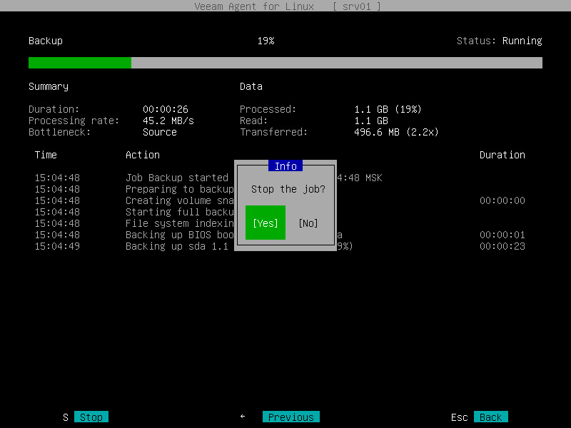

  1. Launch the Veeam Agent control panel with the veeam or veeamconfig ui command.
  2. In the Veeam Agent control panel, in the list of backup job sessions, select the currently running session with the [Up] and [Down] keys and press [Enter].
  3. In the session statistics window, press [S].
  4. In the displayed window, make sure that the Yes button is selected and press [Enter].
