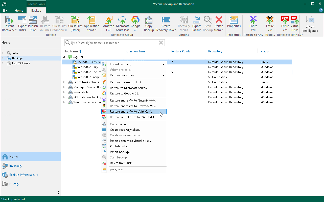

Restoring Veeam Agent Backup to oVirt KVM VM
You can use the Veeam Backup & Replication console to restore a Veeam Agent computer as an oVirt KVM VM in your virtualization environment.
If you restore a Veeam Agent computer to an oVirt KVM VM, consider the following:

Restore to oVirt KVM VM
The procedure of restore to an oVirt KVM VM for a Veeam Agent computer practically does not differ from the same procedure for a VM. To learn more, see the Performing VM Restore section in the Veeam Backup for Oracle Linux Virtualization Manager and Red Hat Virtualization User Guide.
Restore Veeam Agent Backup to oVirt KVM
