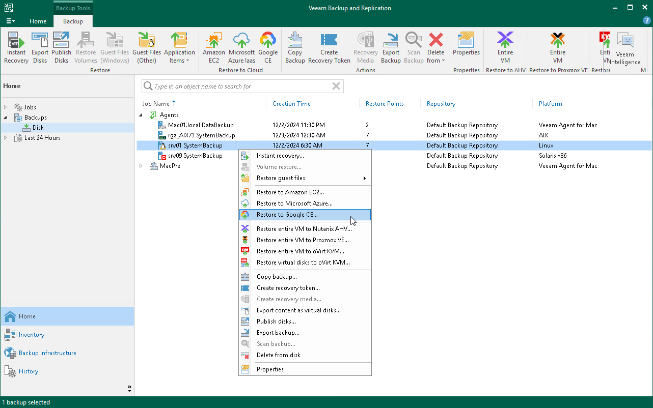

Restore to Google Compute Engine
The procedure of restore to Google Compute Engine from a Veeam Agent backup practically does not differ from the same procedure for a VM backup. To learn more about restore to Google Compute Engine, see the Restoring to Google Compute Engine section in the Veeam Backup & Replication User Guide.
