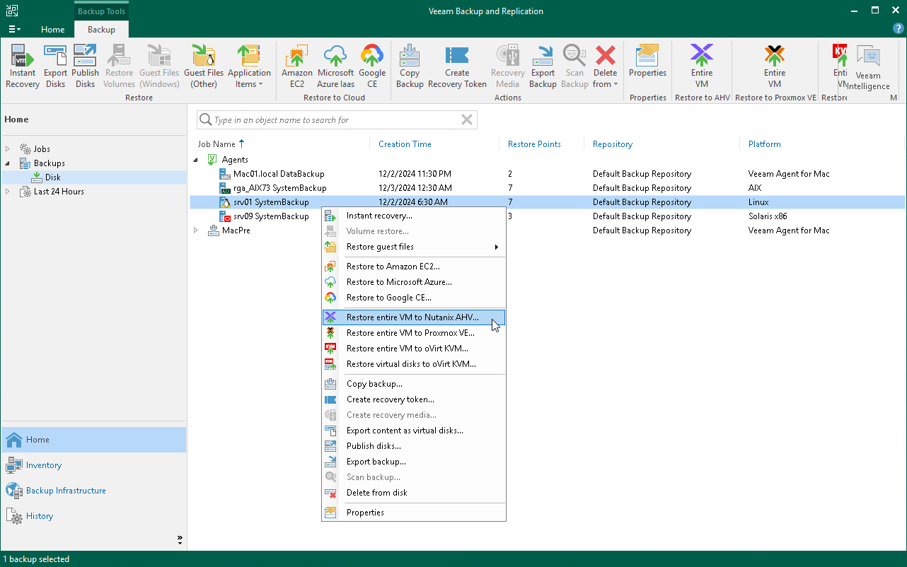

You can use the Veeam Backup & Replication console to restore a Veeam Agent computer as a Nutanix AHV VM in your virtualization environment.
If you restore a Veeam Agent computer to a Nutanix AHV VM, consider the following:
