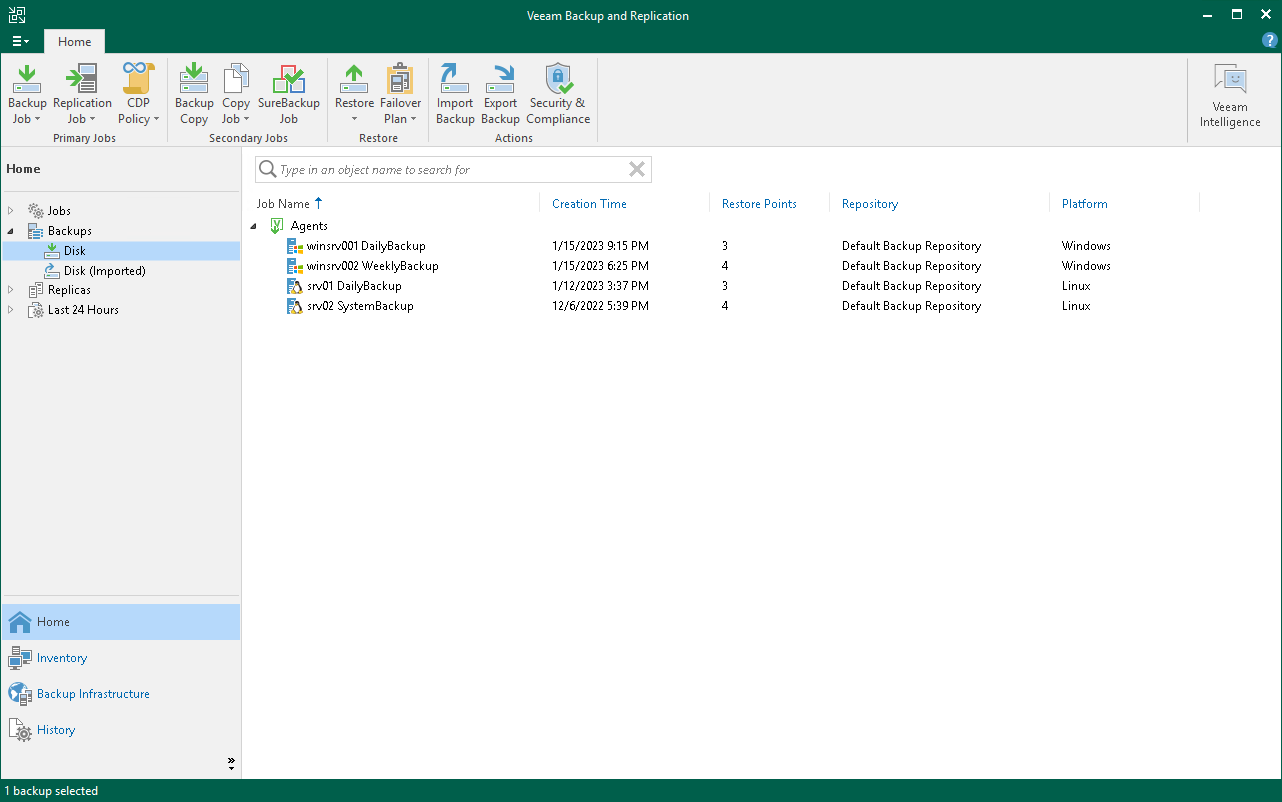

Information about Veeam Agent backups stored on the Veeam Backup & Replication backup repositories, backup jobs and sessions becomes available in the Veeam Backup & Replication console:
  • The Veeam Agent for Linux backup job is displayed in the list of jobs in Veeam Backup & Replication.
  • Backup files created with Veeam Agent for Linux are displayed in the list of backups, under the Agents node.
  • Performed job sessions are available in the History view of Veeam Backup & Replication.
